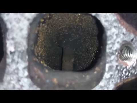

    Also, can you post some picture of the exhaust ports from both heads?

      I have a video of one side and pictures of two port from the other side. I have cleaned it all so cant take new pictures.

                    The exhaust seats are the reason for the failure. As the sea water starts to pit and corrode the seats and the valves, they lose their ability to seal against the valve face and your compression stays low and the same thing happens again. $1250 for all that is actually a pretty good deal. You can do whatever you would like, ask questions along the way and I'll answer them. There's a motto we follow and my employees live by it too; "We only do things one way and can always explain why if you ever have a question." I'm here to help.
