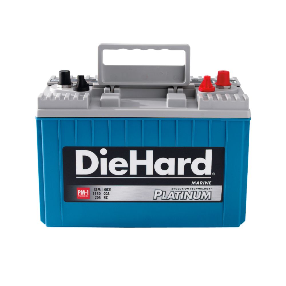

If you want the best and money is no option...This is an Odyssey battery manufactured for sears. Warranty is outstanding!
http://www.sears.com/shc/s/p_10153_12605_02850131000PBoating Lake Mead since 2000
