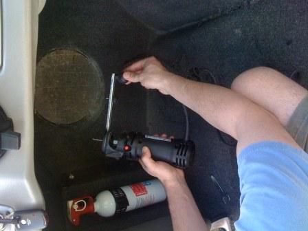

      I just did mine a couple wks ago, same sub. I have a small laminate router and made a jig for just the size hole I wanted. I was told to make the sub fit tight. Cut the carpet and made about 5 passes w/ the router dropping the cutter each time until I was through. Worked great. I will post some pictures when everything is all hooked up.

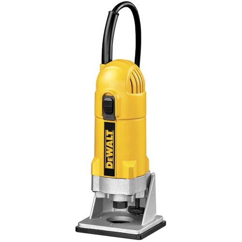

        TRD - you used a router like this? Seems like that would work well, just need to find one.

          That's what I used also. It also worked on the fiberglass in my boat when I had to enlarge my speaker cutouts for my Wetsounds speakers.

                Yes Austin, that router will work great.
                I use a 1/4" ball nose endmill. I'm sure a reg. 2 or 4 flute end mill would work fine. I would do a depth of about 1/4" at a time. I will take some pics of my router and jig. Very simple. Getting the distance from dowel to bit takes a couple of tries but that is it. I use a 1/4" Ø drill to drill the hole in the bulkhead and left the drill bottom for my dowel to spin on. Just remember, you will only get one shot this way so make sure your jig is right. If your drill is not tight you can use a roll pin for a dowel pin also.

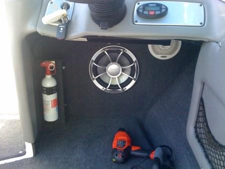

                          The 1st pic is my sub. It is a very snug fit.

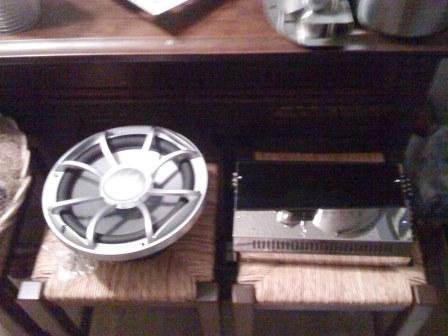

                          4th is items that I am adding this year. I already had the tower speakers from the 1st NC Tigeowners Reunion. I justed cleaned them up and haven't put them back on yet.
                          The 5th pic is my router and jig. Very simple, I put the jig under the base because of the carpet thickness and it has a single 1/4" dowel hole to spin around. It took a couple of try to get the diameter I wanted.

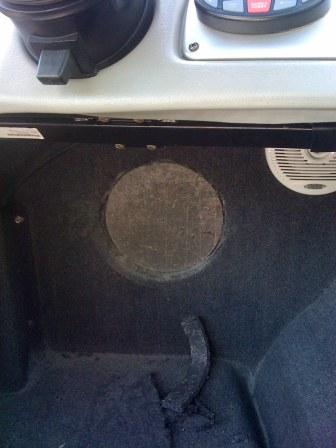

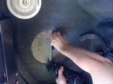

                            Looks good TRD. Glad you guys suggested the jig setup, that was the ticket. I ended up buying a rotozip and what they called a circle cut that allowed me to cut a perfect circle for the sub. Was not too difficult at all, a few passes with the jig and one without so the bit could go deep enough and the hole was cut. Got the amps installed and hooked up too, just ran out of time to tune them. Will do that this week. Here are a few pics, will take more and some of the amp later this week.
                            Thanks for all the help, you guys saved me a ton of time and pain with the jig suggestion.
