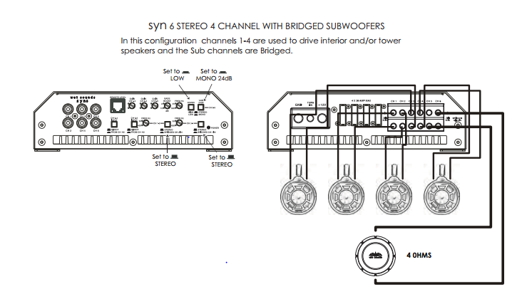

          1 set of bind posts so it must be the single 4 ohm. I got the config from the syn 6 manual, I have not talked to anyone at wetsounds about that config. When I have the gain low and bass boost low the sub barely hits at all. And I even disabled the remote volume just to see if it was that. As I said earlier the factory config was really quiet and the sub was not working hard at all which is what started all of this. And I did make sure the fader from front to rear was centered also on the receiver. Sounds like I need to give them a call and confirm my config. I will do that. One more detail, I am connecting to an iphone over bluetooth to stream my music. Thanks for the feedback!
            Here is the config I am using. I will call wetsounds tomorrow however would love to hear any other suggestions. thanks!
              I would heed caution using BT for tuning, its a step below using the 3.5mm jack in terms of sound quality and signal strength. Use a USB or store bought CD. I think you let the smoke out of that 10" sub before you get the bass you are after. I would consider upgrading to a 12 in an enclosure so you can take full advantage of the Syn-6's 600W rms.
                One other thought that comes to mind, double check to make sure you have the sub wires polarity bridged correctly at the amp. if not, then the sub is firing 180* out of phase.
                  thanks for the info. I will try with USB and double check the polarity this weekend. Also will get a call in to the wetsounds team for advice. I am now wondering is running my ICON 8's off the SYN 6 and my XS -FA - 10 off my SYN 2 makes more sense.
                    The Syn-2 is perfect for a pair or two of Icon-8. It will deliver 200W rms x 2 @ 4 ohm with a single pair or 350W rms x 2 @ 2 ohm with 2 pair. Bridged @ 4 ohm x 1, it will deliver 700W rms. Im already not liking 600W rms to an IB 10" sub. If you had a 12" sub, It would be worth looking at reconfiguring.
